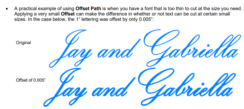

She makes inaccurat SCAL videos, thus I wouldn't trust anything she shows.
Here's a method typically used for thickening letters. Type the text. Select the text. Go to Path>Offset Path and enter a very small Offset size, such as 0.005". It doesn't take much. This is from the SCAL User Manual:
