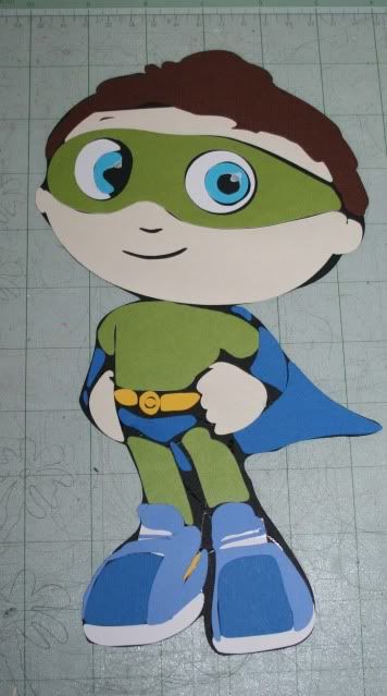

I spent the majority of yesterday trying to learn to create a svg in Inkscape. My daughter LOVES the pbskids show called SuperWHY-I took a coloring sheet & converted that to svg pretty easily
Then I used the paint bucket tool to color in areas to create the layers (and let me say it took forever to piece those little hairs into 1 piece). When I cut it out, it still doesn't look quite right --What am I doing wrong?
Also, I can't figure out a way to cut out the book logo on his super suit, which is an important part.
I am going to attach the svg I created, as well as the image I created.
I did also have the markers draw out th eimage, but of course the lines are like shapes themselves--how do I get rid of that so it's actually lines?
Thanks for any help

The object to path allows the object to path allows SCAL to recognize it and it keeps the shape of the item as it is shown in Inkscape... It seems some of the shapes are off... Otherwise it does look very very cute.. As for the book?? why not just draw the lines on for the book???

You don't trace or convert to path when you use the paint bucket tool, it creates vectors automatically.
One of your layers has an ellipse, that might cause a problem with SCAL2. If you have a piece that looks off when you import it into SCAL, that is probably it. Select it in Inkscape and Path/Object to path.
I think what you needed was a base or mat layer to piece onto. I typically use black, but you can use other colors. I selected all of the pieces, copied them, pasted them into a new base layer, then Control J to make a Dynamic offset. Move the little white square up and away from the image to make the mat. Path/Object to path. I also added a new layer with a book I traced from your coloring page.
I think you are using the markers to draw the book and outline the character? The biggest problem with markers is that they are rather wide. You might try a mini gel pen instead for the book. The base or mat will take care of outlining the character. HTH

OK, I did Ctrl A on the base layer, then CTRL J, moved the little white square & got this black blob-is it supposed to look like that?
I used a mini fine point sharpie the first time to draw the character out, until I could figure out the paper pieceing.....but it didn't draw it as an simple outline, it was like it an outline of the outline.....

The white square was pulled a little too far. ;)
